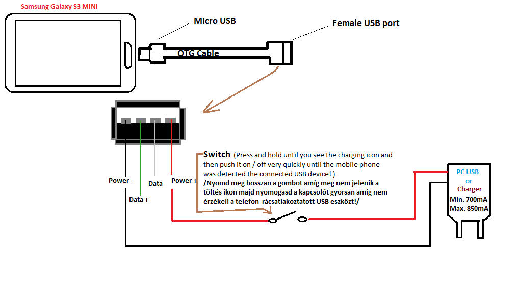

Lightbulb Detalles del dmesg en la terminal
He observado estos datos curiosos en la terminal probando con una pendrive-usb:
Al conectar USB sin alimentacion:
ab8500-usb ab8500-usb.0: ab8505_usb_link_status_update 13
ab8500-charger ab8500-charger.0: USB link status changed
muic_notify is called (0x0d)
Atmel MXT224S 3-004a: mxt_usb_switch_notify: no mode (13) change (0x0d)
ab-iddet ab-iddet.0: accessory_plug_detect Returning from IDDet handler 1827 usblink1status = 68
(Aqui observamos que lo detecta pero no es capaz de leerlo)

Al conectar USB con alimentacion:
ab8500-charger ab8500-charger.0: VBUS rising detected
ab-iddet ab-iddet.0: vbus so returning from accessory_plug_detect
ab-iddet ab-iddet.0: dock_plug_detect going to detect cable connected
ab-iddet ab-iddet.0: release ID_DET_PLUGR
ab8500-usb ab8500-usb.0: ab8505_usb_link_status_update 18
ab8500-usb ab8500-usb.0: ab8505_usb_link_status_update 17
ab-iddet ab-iddet.0: USB-ID 1
ab-iddet ab-iddet.0: GPADC value < UART_BOOT_OFF_MIN
muic-notify is called (0x11)
Atmel MXT224S 3-004a: mxt_usb_switch_notify: no mode (17) change (0x11)
ab-iddet ab-iddet.0: Cable ID Detected present 12 last 15
no cable detected, check if it can be legacy charger
ab-iddet ab-iddet.0: claim ID_DET_PLUGR
usb 1-1: new high speed USB device number 2 using musb-hdrc
usb 1-1: device v125f pcb10 is not supported
scsi0: usb-storage 1-1:1.0
ab8500-fg ab8500-fg.0: [FG-DATA] 537mAh/a500mAh 36% (Prev 547mAh 36%) 3762mV -181mA -127mA -709 0 0 5 1 1 130 27 33 1 0
scsi 0:0:0:0: Direct-Access ADATA USB Flash Drive 1100 PQ: 0 ANSI: 4
sd 0:0:0:0: [sda] 15568896 512-byte logical block: (7.97 GB/7.42 GiB)
sd 0:0:0:0: [sda] Write Protected is off
sd 0:0:0:0: [sda] Mode Sense: 43 00 00 00
sd 0:0:0:0: [sda] No Caching mode page present
sd 0:0:0:0: [sda] Assuming drive cache: write through
sda: sda1
sd 0:0:0:0: [sda] Attached SCSI removable disk
(Antes que nada detecta la elevacion de voltaje en el bus, y cambia el estado de la conexion usb a 13 nuevamente, aunque detecta la entrada de voltaje del conector y posteriormente cambia el estado a 18 y en seguida a 17 con lo que modifica algunos valores que creo son clave en esto, en especial las lineas:
despues de esto cambia el estado nuevamente a 18 y detecta el dispositivo como un sda y lo demas es simple deteccion)
Al conectar la USB sin alimentacion despues de haberlo hecho minimo una vez con alimentacion:
sda: sda1
(Por ultimo ya detecta los dispositivos USB sin necesidad de alimentarlos externamente, y podemos observar que directamente cambia el estado a 18 sin pasar por los estados intermedios como lo son 13, 18, y 17 en orden, ni modifica nuevamente los valores anteriores, solo detecta como si hubiera alimentacion entrante al bus, y monta directamente la pendrive-usb como un sda)
Si logramos hacer que algunos de esos valores sean modificados desde el arranque del telefono posiblemente funcionara el otg por default

Los pen tienes que estar en fat32 si estubieran en ntfs no te los leera excepto que en alguna rom cocinada tenga soporte para ntfs

este man lo conecto asi jjj
